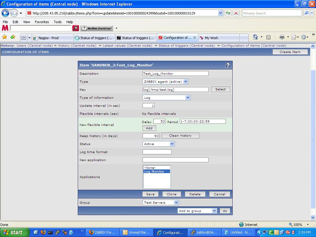

                            What if you turn debuging on, on both zabbix_agentd and zabbix_server ?
                            Hostname "SANDBOX2" is the right case ?
                            Does zabbix have read access to the log file ?
                            On the server, item time is declared as "Agent (Active)"?
                            Type of information = Log ? Update interval: 1 sec ?
                              YES, please check the attached image file.
