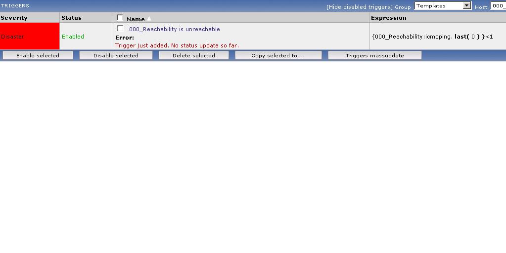

    Hi, I'm playing with zabbix and figuring out how things, work, one question though, when I add a new trigger, get "ERROR: Trigger just added. No status update so far." in the error message, I did search in google but only found the source code, and according to the source code this is the default value sent to the database for the error column when the trigger is created. The trigger works correctly though, it creates events that show up in the event page.
    The trigger is created on a copy of "Template_Linux" named template_linux2 (Disabled a few items that were not monitored), which has one host has assigned to it.
    I think that because "Template_Linux2" is no real host the status is not changed, and thus giving me this error. I say this because when I look at the triggers of the host that is using this template I am not getting this error.
    I don't think this is an error that really matters but I still would like to get rid of this error though...
    I'm using zabbix 1.6.2 for the server & agent.

    i'd like to report that i'm getting the same error also but my template_linux doesn't report any errors. only additional templates that are created get this.

        i have freshly installed Zabbix 1.6.2 on Ubuntu 8.10 and encounter the same error message "Error: Trigger just added. No status update so far." in most of the already pre-installed templates. Also I after creating a new template I have this error message.
        i have been searching the net but have no information found to solve this problem. It would be great if someone has a solution to this...

          I have this error message to, what i can guess is that this "error" message only shows up when a trigger is attached to a Template, (there is no data to collect from a template, can only collect data from a device).
          Instead try to look at one of the devices that are attached to the template to see if you have the same error message there.
