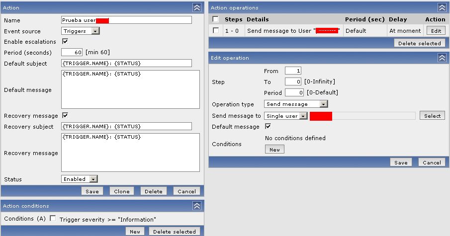

7. the action is really simple:
But nothing is executed. The trigger is raised and an event is created with severity disaster, status problem, etc.... But no actions are being executed.
