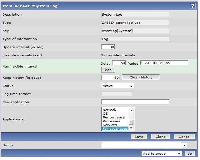

          What is your key definition for the item(s)? I use "eventlog[System]" to monitor my system logs.
          • Mindaugas
            • Jan 2009
            • 10
            Key definition is the same. See attached image.

              Well, that is exactly like mine! Three other things you might try.
              1: Make sure port 10051 is not blocked. Active checks are done through a different port than passive checks.
              2: Make sure that the option "DisableActive" is not set. (not =1)
              3: Set your log levels to 4 in the config file and watch the log for when it sends active checks. You should see something like this:

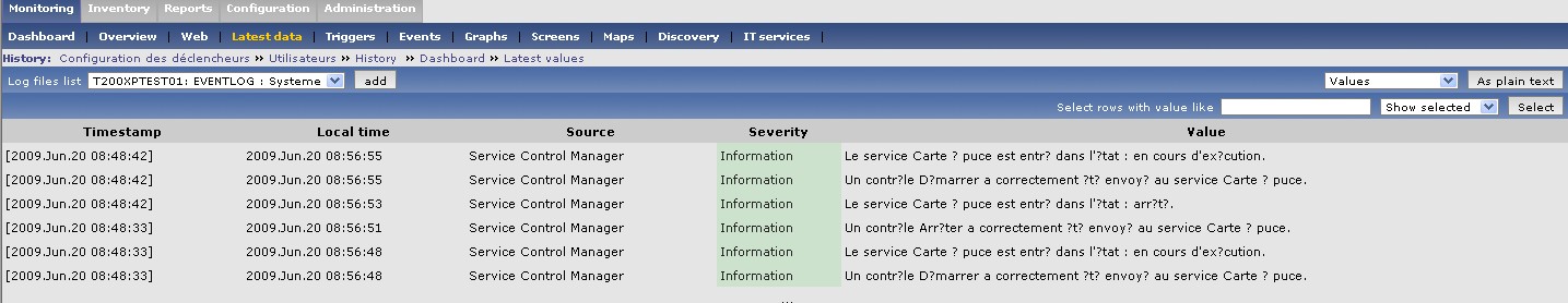

                      • hiacine
                        • May 2009
                        • 18
                        Your config file seems to be good.
                        Do you see something in your zabbix console ?
                        Monitoring --> Last data
                        click on the link history wich is in
                        Windows_Logs --> System Log --> history
                        Something like this :
                        • Mindaugas
                          • Jan 2009
                          • 10
                          Of course, not. As I've wrote earlier, I've been monitoring 5 servers with identical Zabbix Agent and Firewall (turned off) configuration, Windows Logging works on one of them, others logs are empty.
