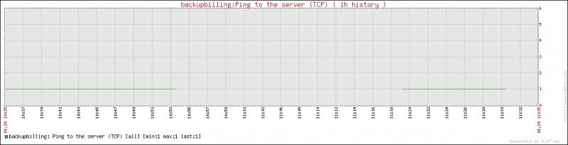

        Graph
        I have attached a graph.
        You can see there is clear gap when box is not reachable, but at that time three is no trigger. Last value is always 1 , proxy does not report timeout.
        What should I look for next?
        Thanks in advance.

            your logs showed agent.ping item being used. as far as i remember, this item either provides data, or not - if it's 1, agent is responding, if it's missing data, agent is not responding. use nodata() trigger function together with this item.

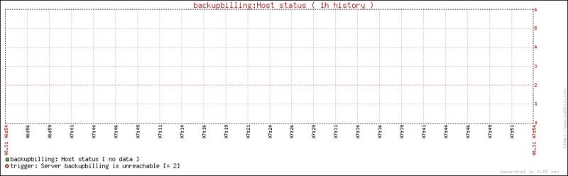

              Host.status
              Rich,
              Thanks for very informative reply.
              I am using default Windows Template , and it has "status.last(0)}=2", but when using proxy looks like host.status is never updated, and looks even if current status = 2 ( unrechable) I dont see any active trigger in "dashboard".
              Is this normal behavior? or I am missing something?
              Thanks in advance.
              • richlv
                Zabbix Certified Trainer
                • Oct 2005
                • 3112
                a-ha, that you didn't tell before. yes, special item "status" is not passed from proxy to zabbix server - you will have to use agent.ping.nodata(900)}=1 or something similar - consult manual for details.
