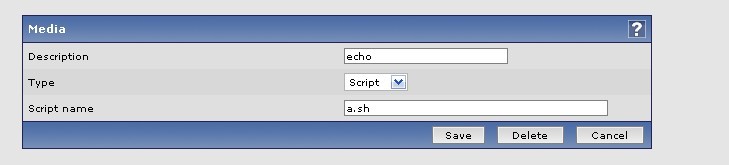

    a create a sh script named a.sh
    #!/bin/bash
    echo "$@">/home/zabbix/a.txt

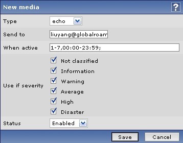

    and then add a media type echo
    and also add the media echo for user test

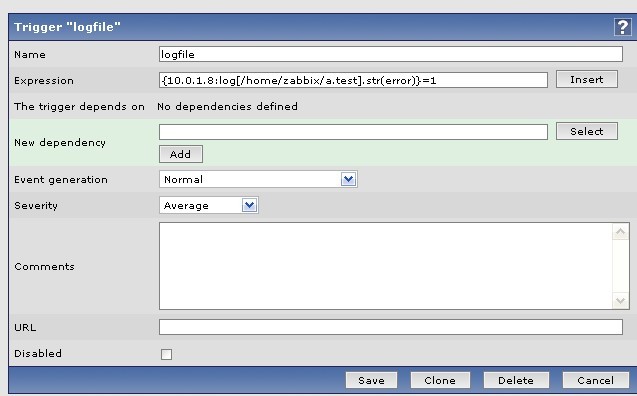

    then add a trigger for host 10.0.1.8

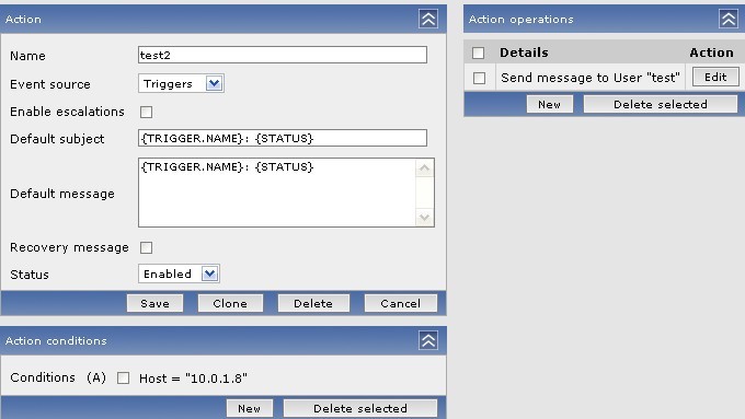

    the add the action test2 for host 10.0.1.8

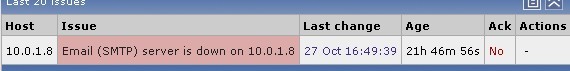

    but when the smtp server down on 10.0.1.8,the action didn't execute...

    Hi.
    When using Recovery messages it's mandatory to add the Action condition:
    Trigger value = "PROBLEM"
    Try unchecking 'Recovery message'
    Does your file have the correct permissions?

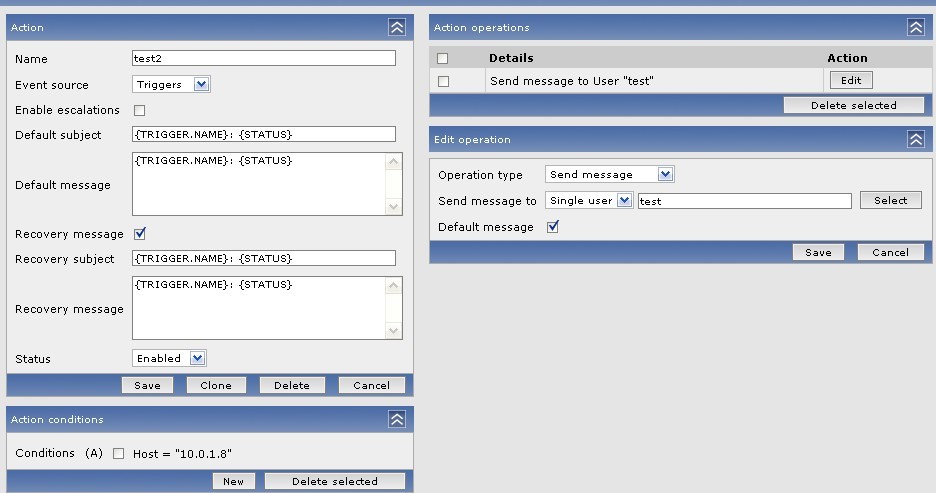

      thanks for you reply,zen.
      I unchecked the 'Recovery message'
      and the file also have rigth privileges
      but unfortunately the action still didn't execute
      my zabbix version is 1.6.6,is that a bug?

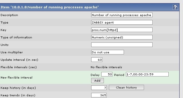

            thanks。。again
            but in the item had set the keep time as the pictures..
            it seams it didn't save the data in db...
            • zabbix_zen
              • Jul 2009
              • 426
              If in Monitoring -> Latest Data you aren't receiving Latest value for 'Number of running processes apache' in the Processes List then something's wrong with your zabbix_agentd.

                the item is running and receive rigth data from agentd but the action based on this trigger is not run..,
                for example I set a trigger like {10.0.1.8roc.num[httpd].last(0)}=0
                but when the number change to 0,the action didn't execute...and don't find any log about it..
