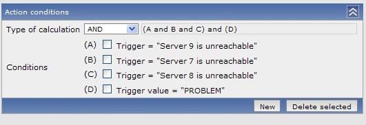

    Ok, so I'm looking to create an action that checks 4 virtual servers on 1 physical box and if it detects that all 4 virtual servers are down at the same time it launches a special action.
    So far the trigger setup I've come up with is something like this. But I'm curious what the evaluation process will be? Any thoughts?

    The action you configured will just check the current status for each of the shown Triggers and launch a remote command when all of them are ON.
