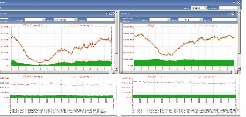

              I don't know if this helps you or not as this workaround has already been posted. Since you'll be using a TV you'll have plently of area to do this.
              Create a URL screen with the following option
              Replace the IP with your servers IP.
              You can get the graph ID and sid by looking at the source or even the address bar of the graph you want to add and dont forget to add the fullscreen option. You'll basically have to play with the width and heights of the graph you'll want to create through this screen. After playing around a bit this is what I was able to get. The image got cut a bit when I printscreened the thing. I'm using ver 1.6.6.
