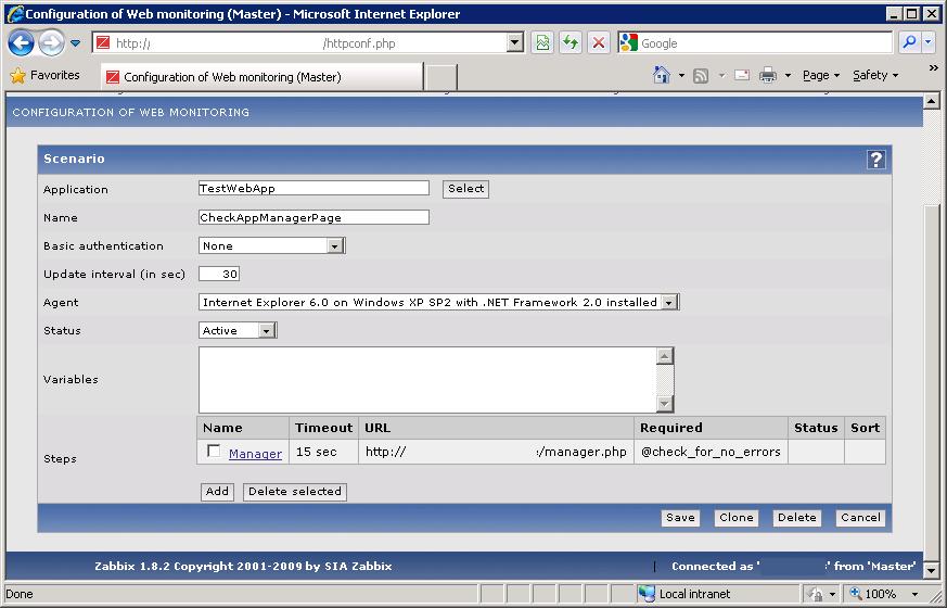

    Hello. I'm configuring a web monitoring. Certain step must fail if certain word appears.
    It is possible with the actual regular expressions?

    I'm investigating the same question as well, but with no luck so far.

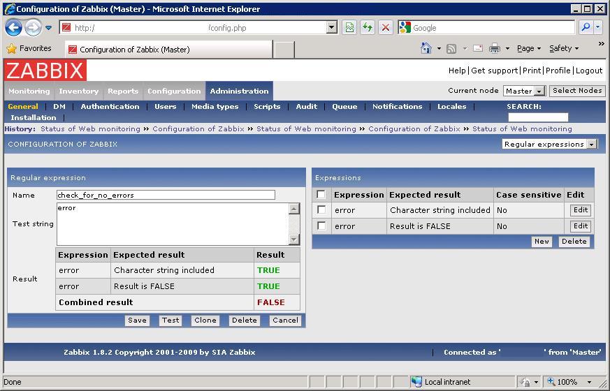

    I created a regex using regular expression builder, to check if there weren't any errors on control page. Expression tests out just fine.
    And used my regex as suggested in documentation - @check_for_no_errors
    But in zabbix_server.log I see the message Page didn't match [@check_for_no_errors] - wether the "error" phrase exists on the page or not.

        Hi Arly. I dont speak English very well and i'm undestand thay you solved my problem.
        I Tried the same and if i put a regular expresion made with de regular expression builder nad seems that doesn't work. It seems that i only can put a direct posix Regular Expression in the "Required" Field".
        It can be a bug in th system?.
