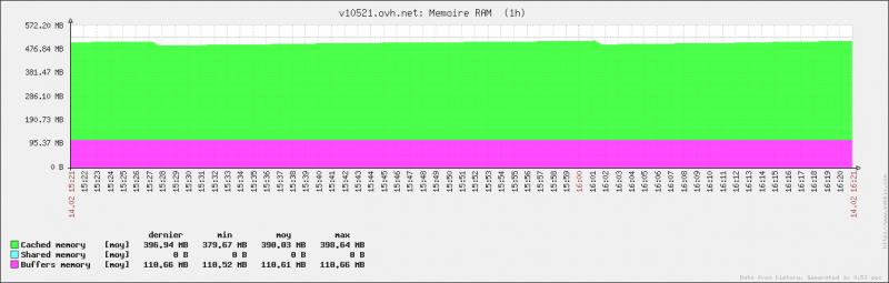

    Hello all,
    I want to create a memory usage graph, using specific Y values:
    - min: 0
    - max: total memory
    The problem is that the total memory is depending of the server and I want to create this graph in a template. That's why I used an item as max Y values: "Template_Linux:Total memory"
    Perfect! It should be great. The problem is that the max values isn't printed... It is like if I choose "Calculed"...
    You can see it here:
    It is possible to fix the Y maximum using an item, which is static ?
    Thanks in advance,
    Samuel.

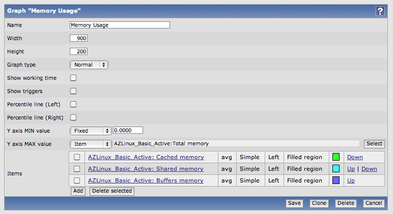

        Sorry, i didn't understand ...
        Look my configuration...

                Ok, I upgraded to 1.8.2
                If I try to link the Y axis MAX value to an item (in this case SNMP IF-MIB::ifSpeed), it returns an error: Incorrect item for Ymax value
                The Item value returned is an Integer, Decimal
                Graphs previously created with linked items have the option set to "Item", but no item selected.

                  if graph refers to items from template, you should be able to select reference item from that template only
                  • Zaniwoop
                    • Jan 2010
                    • 232
                    The Ymax item and the graphed items are all fro the same templte
