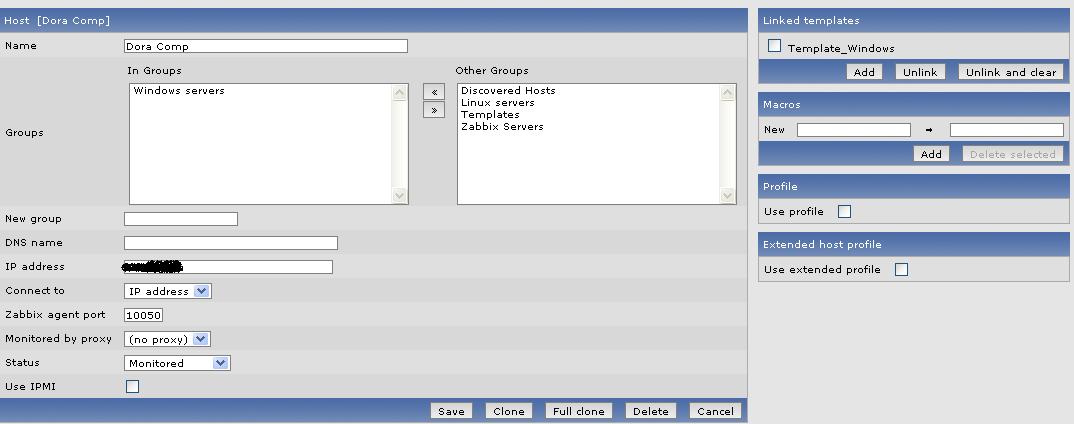

                            • yuhuu
                              • Jan 2010
                              • 30
                              #15
                              i realised the mistake after i refer back to my zabbix_agentd.conf in zabbix server.
                              i had change it in the zabbix_agentd.conf
                              hostname=Dora Comp
                              and for the template.i use template_windows.
                              did u mean by change it "template_windows" words to "zabbix_agent"?
                              how can i do that sir?
