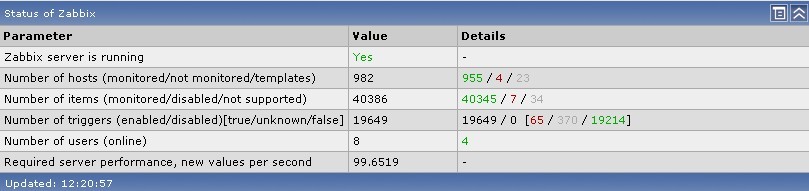

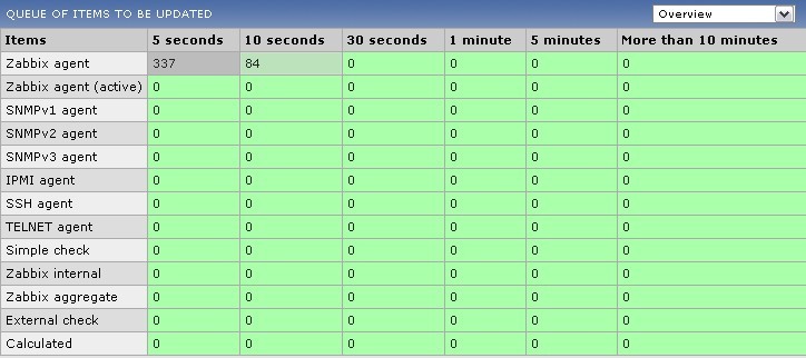

    Following are our organization zabbix system online status
    SO it was work fine.
    I want to config the jabber for zabbix to report the warning information.
    but I can't found zabbix 1.8 manual about this contents.
    who can tell me about jabber setup for zabbix.
    I installed jabber server in our network,it dons ok.
    So next what I can do? pls..
