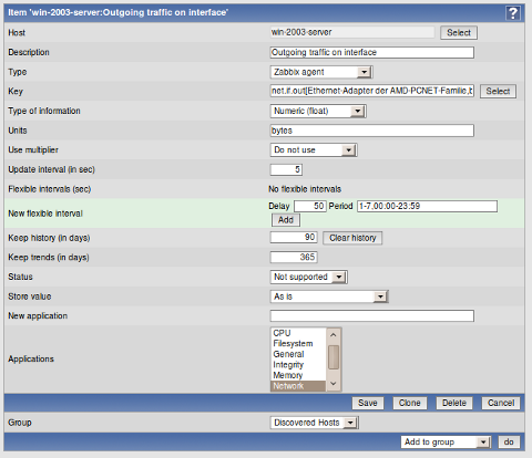

    I've got a problem to request the net.if in/out data form Windows Clients.
    I tried a lot of things like renaming the interface to eth0 in the interface properties and request it with
    net.if.out[eth0,bytes]
    But I always get the following message:
    Item [win-2003-server:net.if.out[eth0,bytes]] error: Not supported by Zabbix Agent

          I done all the things that you describe but I get always the same error message:
          2772:20100331:130048.115 Item [win-2003-server:net.if.out[Ethernet-Adapter der AMD-PCNET-Family,bytes]] error: Not supported by Zabbix Agent
          A german abstract of the perfcounter.txt:
          \Netzwerkschnittstelle(Ethernet-Adapter der AMD-PCNET-Familie)\Bytes gesendet/s
          \Netzwerkschnittstelle(Ethernet-Adapter der AMD-PCNET-Familie)\Empfangene Bytes/s
