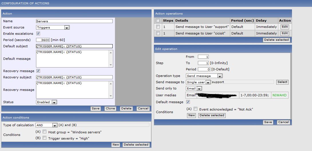

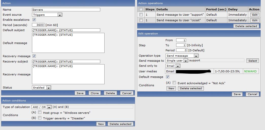

    I don't know if this is an email issue or an improperly configured action.
    I shut a monitored server down and it kicks off a disaster level warning in he console.
    I have the
    Action set with the following condtions
    Host group - windows servers
    trigger severity = disaster
    and I use the and clause as I would want it to fit both.
    I have i set with 2 actions to mail 2 different email addresses I have configured with a user and the condition is event acknowledged-not ack
    the server is down and not acknowledged and nothing
    I have tried 2 smtp servers and I get no luck with either and I know one is our production server and the other smtp server was working but appears to be having issues atm.
    I have now tested both SMTP servers from another system I use to monitor our websites which uses no authentication and it passed through with no issues. I know the Zabbix ip address is address as an authorized server for pass through as well. I watched the SMTP server and it didnt even look like it was touched with a connection. I have used both ip and DNS name for the servers.

    Just at a basic glance, you say you have that trigger set as "disaster", but in your configuration for the conditions, you have it set to trigger on severity "high".
    Two different things.
      Yeah I though ti copied the disaster, but I coped the high one instead...
      I have an action for both as high level and disaster we want notifications from.
      I am not getting notifications from either.

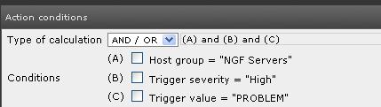

        Something you may want to try is adding a third condition of trigger value = problem. I use that setup successfully. There are those who will argue it is not needed, but I have seen others not use it and have problems. When they included it, the alerts then worked for them. *shrug*

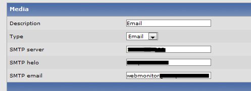

          here are the media Settings
          Add the third and put it as an and right?

          I have tested the SMTP settings form other computers and they work correctly. I have also tried an open relay server and nothing goes out. I would honestly prefer to use gmail servers, but it requires authentication which is not an option that I see.

            You can add trigger value=problem as an "and"... it will not hurt anything. that trigger is going to fire when it is a "problem" anyway.
