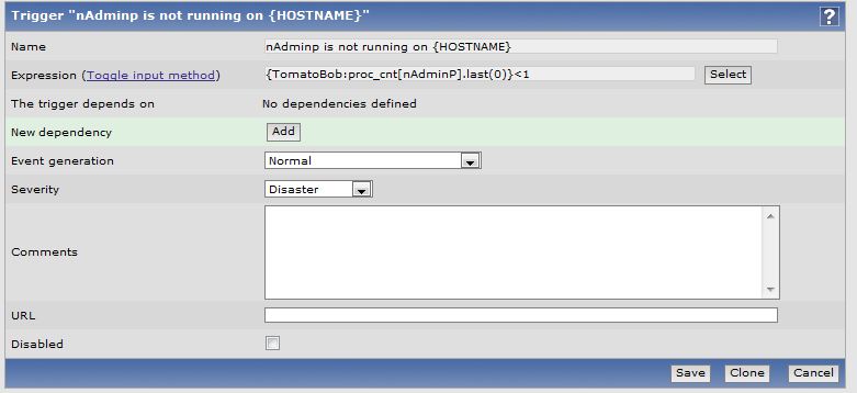

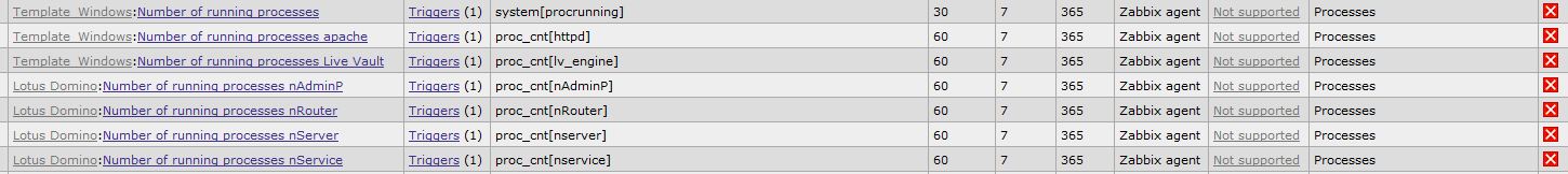

I am working on monitoring some specific processes on different servers. I used the standard httpd settings to create the triggers and items, but they are all not supported.
Proc_cnt is the default with HTTPD which is not supported
I can get proc.num to work but I cant seem to get a good trigger.
I basically want to send an alert if the process has less than 1 running
