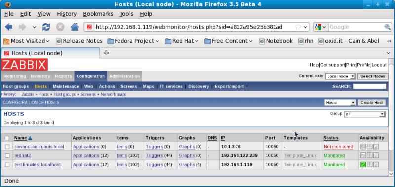

        I added Template_linux, still I get same error host not found.
        • uknet80
          • Apr 2010
          • 55
          #19
          some progress.
          on the server side i change NodID = 1, as you can see from the image Z letter has changed from gray to Red, which means, it some change happened. still I am getting the folloing error on the server side:
          Item [redhat2:agent.ping] error: Got empty string from [192.168.122.239]. Assuming that agent dropped connection because of access permissions
          I assume the problem is from zabbix_server.conf file.

              I set NodeID=1 under zabbix_server.conf, now zabbix_server can see all agents. i hope this wouldn't generate other complications

                  Originally posted by alixen
                  You have to make sure that server name in Zabbix server and agent are the same. See my remarks below.
                  According to screenshot this machine is called "Zabbix Server" not "test.linuxtest.localhost" in Zabbix.
                  According to screenshot this machine is called vm not mv in Zabbix.
                  Rename host "Zabbix Server" to "test.linuxtest.localhost" and replace "mv" by "vm" in zabbix agent configuration and it should be OK.
                  Regards,
                  Alixen

                    The hostname specified in your agent config file must match EXACTLY the name of the server I'm the GUI. If it doesn't, then you'll get the messages that you're seeing.

                      Confirmed Alixen's answer worked for me. Thank you.
