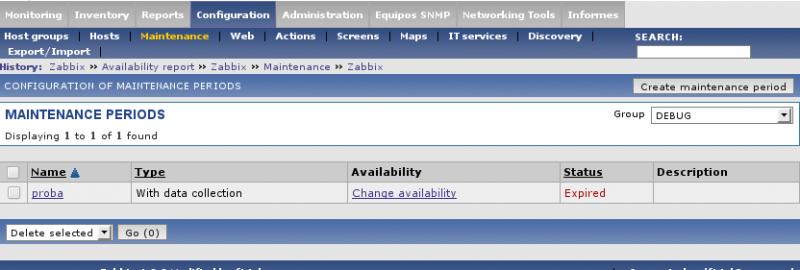

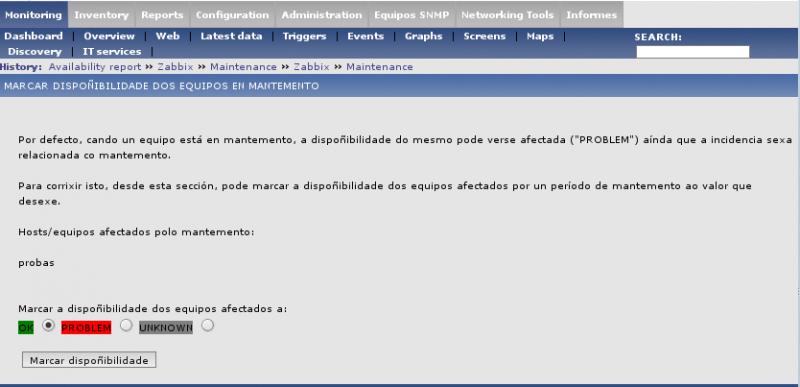

        After some searching, I decided to create a PHP page in order to "fix" this.
        The page allows you to select an expired "Maintenance period", and by clicking the link "change availability", you well be able to change triggers status belonging to hosts in the maintenance period
        So after a maintenance, you can decide if trigger status was OK, PROBLEM, UNKNOWN.
        Screenshots attached (some texts in galician language)
        I'll attach later (no I'm out of time) the PHP code, and patch to include the link "Change availability" in maintenances.php page.

            I finished the patch and also added a little feature to know the status during maintenance period, before changin it.

              patch attached
              Patch attached.. Please read the "readme" file because this patch needs to change some zabbix source code files.
