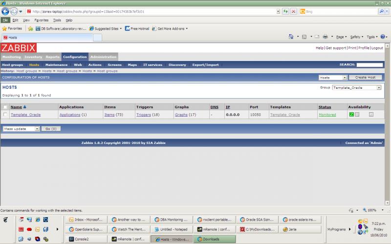

          I believe I got what you mean, but I just want to make sure if I understand it correctly.
          Below is an excerpt from the template that I imported to the Zabbix server. Does that mean the <hosts> line should have the name of the host/server before I do the import? FYI, the host is already getting monitored and is part of an existing Host group.
          The template that am using is similar to the one that the author posted in another topic.
          From orabbix.log, it shows something as below. Not sure where is the <host>REIx</host> is coming from? I don't have REIx define anywhere?
          I've uploaded the orabbix files that am using, hopefully you can check and advise if there is anything wrong somewhere. FYI, I took out the jar files and other big files otherwise I will not be able to attach the zip files.
          I've uploaded a screenshot of what the Hosts look like now and I have one named Template_Oracle which is the name that is on the <host name="Template_Oracle"> line of the XML file, is this what you mean that I have to do on Zabbix?
           2010-06-18 06:16:05,630 [Zabbix-sender] DEBUG Orabbix - received OK
           2010-06-18 06:16:05,630 [Zabbix-sender] DEBUG Orabbix - sending <req><host>REIx</host><key>c2dhX2ZpeGVk</key><data>MS45NQ==</data></req>
           2010-06-18 06:16:05,631 [Zabbix-sender] DEBUG Orabbix - received OK
           2010-06-18 06:16:05,631 [Zabbix-sender] DEBUG Orabbix - sending <req><host>REIx</host><key>c2dhX2phdmFfcG9vbA==</key><data>MTAw</data></req>

          • newbie01.oracle
            • Feb 2010
            • 18
            Hi mwiewior
            I kept on repeating what you said over and over and over ... "You need to add hosts to monitoring that have the same names as you put in the orabbix configuration files and apply oracle_template on them" ... and guess what, it is finally working now ... am getting data across ...
            From the log, the host tag still says gibberish ... oh well, maybe that is by design
             2010-06-19 01:48:02,625 [Zabbix-sender] DEBUG Orabbix - sending <req>[B]<host>QU1TWFhY</host>[/B]<key>ZGdlcnJvcg==</key><data>bm9uZQ==</data></req>
