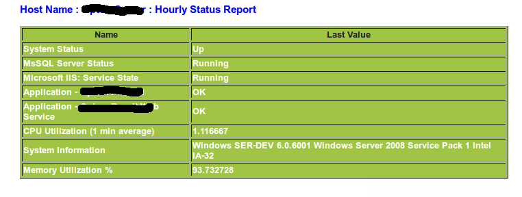

                  Consolidated Reoprt through Email
                  I dont know that what I developed is proper or perfect thing that you are looking. Am just sharing a sample report screenshot here.
                  Please reply if it is relevant.
                  Jithesh R

                    Thanks for the screenshot. I'm more looking for graphs etc, but would you mind sharing the SQL that use used to extract the data? It may give me some clues in to what I'm trying to do.
                    Also, what method have you used to automate sending an email with the results?

                        Screenshot
                        The screenshot wat i attached is Consolidated Mail. We can set it based on time to multiple e-mail id's.

                          Method used
                          Method used: PHP, mysql, PHP mail function to send mail using smtp.
