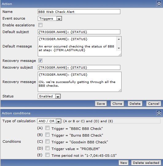

    I have an action configured but I don't want to get alerted on that action between the times of 04:45 and 05:15 every morning. So I created the action condition:
    Time period not in "1-7,04:45-05:15"
    but I am still getting alerts when the trigger is fired during this time period. Any ideas why this is not working? I've attached a screenshot of the action.

    I am having the same problem. Have you resolved this? I'm running v1.8.4
    I'm actually getting the recovery message during periods when i should not. I did some searching thru the forums and the solution seems to be adding Trigger value = "PROBLEM" to the action. However, even after adding it i am still getting recovery msg's during time periods that i should not.
    Anyone else run into this?

      I don't think I ever got this working. What I ended up doing as a work-around was adding the hosts to a "Maintenance" with the time period of interest and then adding
      Maintenance status not in "maintenance"
      as one of the Action conditions.
