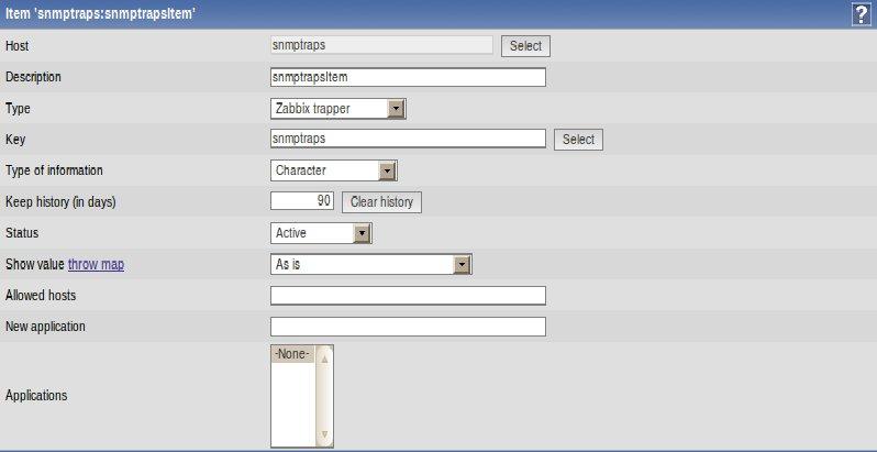

    I've created a host and an item in zabbix. See attached image.

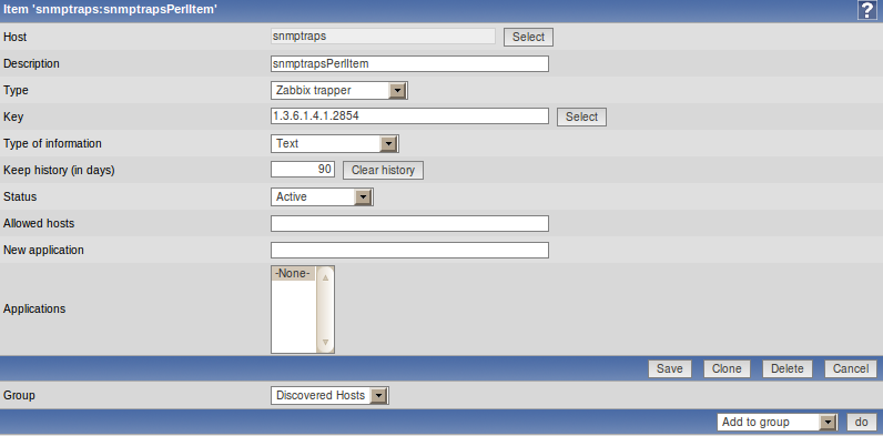

                      I added the line and I get this in the log file:
                      /home/zabbix/zabbix-1.8.2/src/zabbix_sender/zabbix_sender --zabbix-server 127.0.0.1 --port 10051 --host 127.0.0.2 --key snmptrapsPerlItem --value "(sfjwindows.network.int, 10.0.2.15) , .1.3.6.1.2.1.1.3.0: 0:21:03:17.07, .1.3.6.1.6.3.1.1.4.1.0: .1.3.6.1.6.3.1.1.5.4, .1.3.6.1.4.1.2824.1.0.0.1: .1.3.6.1.4.1.2854, .1.3.6.1.6.3.18.1.3.0: 10.47.247.221, .1.3.6.1.6.3.18.1.4.0: \"public\", .1.3.6.1.6.3.1.1.4.3.0: .1.3.6.1.4.1.2854"
                      2010-07-19 09:51:42 -- 31686 --Error sending command. Output is: Info from server: "Processed 0 Failed 1 Total 1 Seconds spent 0.000075"
                      sent: 1; skipped: 0; total: 1
                      The traps that I create are supposed to have the OID 1.3.6.1.4.1.2854. And that was supposed to be the key in the zabbix item right?
                      My Zabbix item looks like this:
