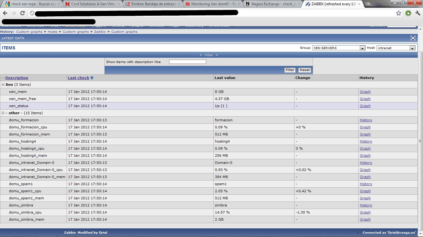

                    well.. after some time without taking a look at this task, last days worked hard on this.
                    Now, I´ve this approach:
                    -have a perl script which basically does: auto-discover xen server running nagios nrpe plugin (with check_xen), execute check_nrpe -h $HOST -c check_xen, parse output, auto-add this xenserver with a predefined template, auto-add items with mem,cpu and domain name for each xenserver discovered.
                    -also detects if one domu migrates from one xen-server to another and moves its items to new xen-server in zabbix (so history of domu remains intact).
                    Now, future plans: replace nrpe plugin from nagios with (if it´s possible) a one command which zabbix-agent could execute it and that will output the same that nagios plugin does.
                    at this moment, worst part is that my perl script needs nagios plugin output... any help on this will be really appreciated
                    More future: auto-create graphs (cpu usage and mem usage) from domus foreach xen-server
                    All automated steps are done with zabbix api (using perl json)
                    Tomorrow I´ll post the scripts.. now I´m at home..
                    Please, if I forget to post the script, please comment in this thread.. I´ll post as soon as I can.
                    Cheers.
                    • fjrial
                      • Feb 2010
                      • 140
                      #25
                      For those who doesn´t know how check_xen nrpe plugin works.. this is the output that it generates:
                      XEN OK - VM : Domain-0: hosting1: hosting2: hosting3|{totalMEM=8023} Domain-0=1065205;383 hosting1=19464540;768 hosting2=9875774;768 hosting3=11454148;512
                      which basically means: XEN $status - VM : $domain1: $domain2: $domainN|{$total_mem_xen=xxxx} $domain1:$cpu_usage_domain1;$mem_usage_domain1;etc ..
                      updated: posted a nice screenshot with info obtained from one xen-server
                      Last edited by fjrial; 17-01-2012, 19:01. Reason: posted a nice screenshot with info obtained from one xen-server
