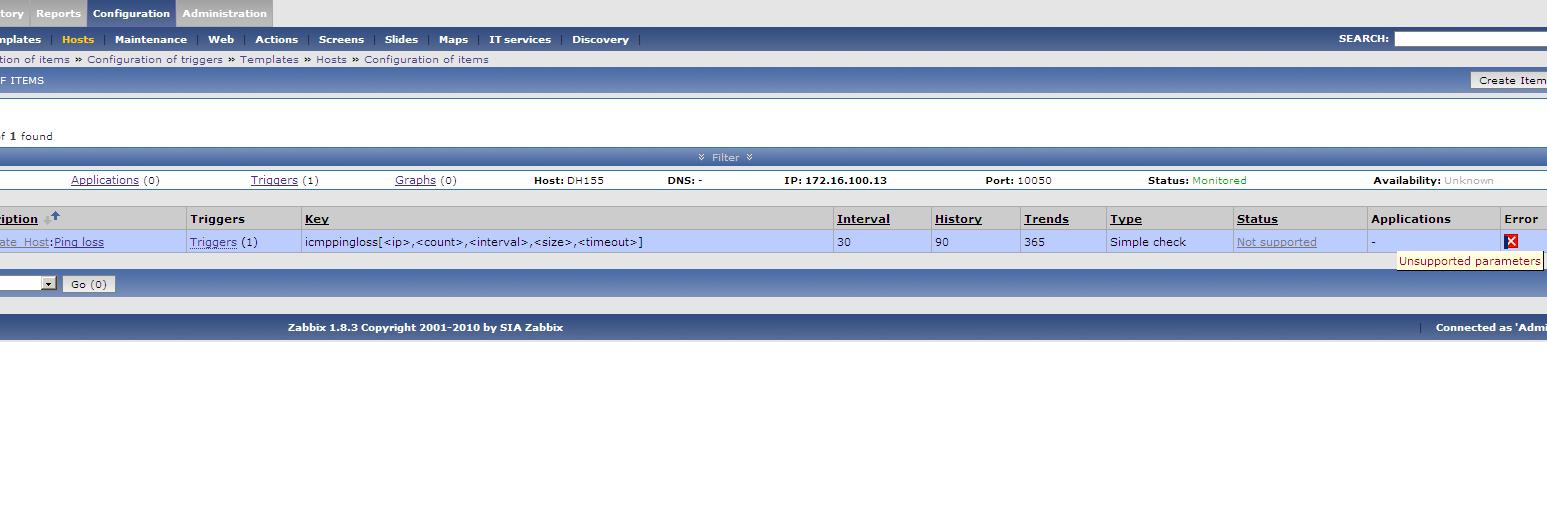

    for details, i have this messagge "Not supported"
    why ?
    i try to enable but after some minutes,it appears same messagge.
    thanks for your help

      Originally posted by fabiomc
      {DH155:icmppingloss[<ip>,<count>,<interval>,<size>,<timeout>].last(0)}>33
      Have you replaced <ip>,<count>,<interval>,<size>,<timeout> parameters with actual values ?
      <something> is Zabbix notation to indicate that something is an optional parameter.
      If default values are OK, you can just use icmppingloss[].

        pingloss
        in the template there is this item :icmppingloss[<ip>,<count>,<interval>,<size>,<timeout>]
        i must put some parameters ?
        you can put an example ?
        for ip,i associated this template to a host so it should take this ip.
        it's correct ?
        • alixen
          • Apr 2006
          • 474
          As I said before, all parameters are optional.
          icmppingloss[]
          should be OK.

              As Alixen said. These parameters are optional! Delete them and just use icmppingloss[].
              If you don't delete them you must specify them!
              Example:
              icmpping [192.168.1.1,,,]
              The words in brackets < > are placeholders!!!!

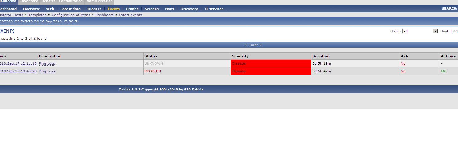

                          • fabiomc
                            • Nov 2009
                            • 53
                            as key in TEMPLATE i have put icmppingloss[,10,6000,,,]
                            it's correct as you have said me?
                            in EVENTS i have theese actions
