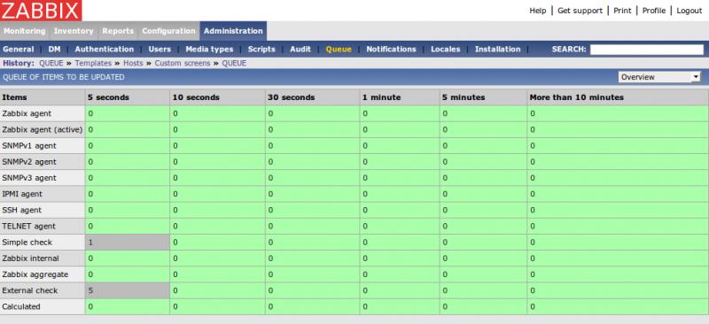

        • alixen
          • Apr 2006
          • 474
          Originally posted by nima0102
          I did not understand you mean.what should I check in Queue ??
          I mean look at the screen (example attached) and, if you are really having problems with zabbix agent items, you should see a lot of non zero values in the line "Zabbix agent".

          • nima0102
            • May 2010
            • 106
            Thanks a lot for your attention
            I have check Queue for 30 min and every 5 second refreshed that page in order to see changes in realtime.there is no non-zero in zabbix-agent field.
            But My issue is not solved.
            The trigger is fired in 3:44:6,but that item had value in 3:43:5 and 3:42:6!!
            I think zabbix does not insert immediately to database after fetched one items.that means,
            zabbix fetches value1 and value2 for item X,and does not insert to database(these values cache),in meanwhile for check triggers,the databases is checked that has no any value in 120 second so trigger is fired!
            Thanks for more information.
