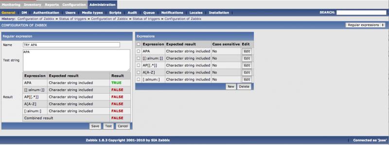

    Richlv says I'm not using the reg exp try out right, that might be ooh so true.
    If I'm using 'RESULT is TRUE' it gives me what I want. But that's actually not the problem.
    This is the problem:
    {Template_HP_Procurve:ifAlias1.regexp([[:alnum:]])}=0)
    That wont work and it did in 1.6.

        Well, wrong of me. I still can't get my original problem solved actually. What's wrong with? Someone?

          how about:
          regexp([:alnum:])}=0 ???
          Greets
          Patrick
