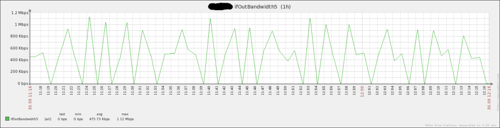

My problem is that although ifOutOctets5 is read correctly every 60 seconds my delta value ends up with spikes of zero value or double the value of the actual delta.
My guess is that the calculated item is being processed sometimes before the ifOutOctets5 item is read and sometimes afterwards.
Both items are polled every 60 seconds.
