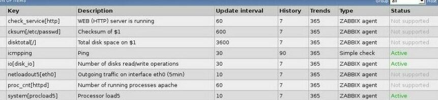

    I'm running server and agentd on the same FC4 server. Most of the monitors are not supported, why ?

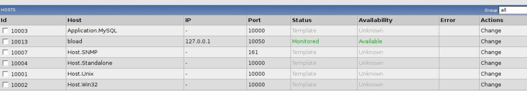

    I forgot to add that I don't get any triggers listed for the host i'm monitoring. How are they added?? Please look at the posted pics. Thx.

      Which version are you using? This is probably due to the latest versions using different naming conventions for items.
      For example,
      check_service[http]
      is now
      net.tcp.service[http]
      See the documentation here.
      -cameron

        Note tht simple checks were broken in 1.1beta4. Please consider using 1.1beta5.

          I'm using version beta5 - I simply got the monitors while selecting host.unix, the ones that show up under agentd.
