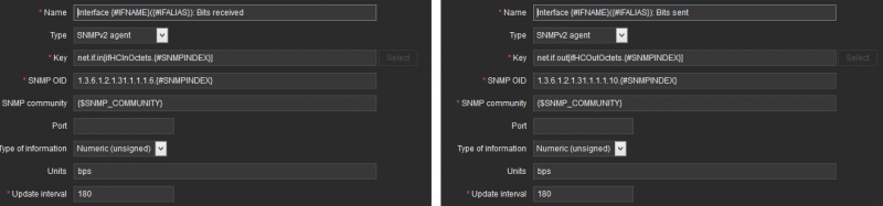

                Hi aib can i made that?
                I've two snmp agent items (look the picture)
                And I need to create a Calculated Item to sum the totals of both SNMP Agent Items, and I'm confused about how to create or write the correct formula.
                I need this because I want to calculate how much percentage of bandwidth I have used over the available bandwidth of a link.

                  Create a "calculated" Item prototype and use formula:
                  last("net.if.in(ifHCInOctets.{#SNMPINDEX})")+last( "net.if.in(ifHCOutOctets.{#SNMPINDEX})")
                  I'm using a similar formula to calculate total traffic going through Internet port.
