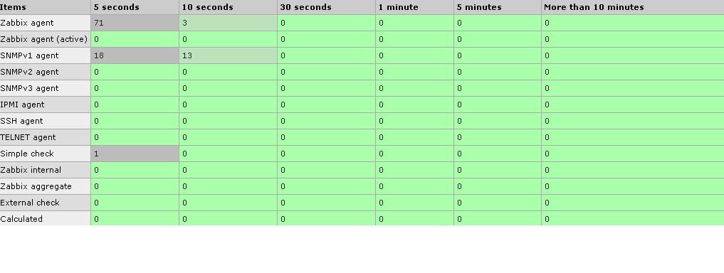

              Personally, I made some changes requested in zabbix. Is configured as follows now:
              StartPollers=10
              StartTrappers=10
              StartPingers=10
              StartDiscoverers=1
              StartHTTPPollers=1
              HousekeepingFrequency=1
              CacheSize=32M
              CacheUpdateFrequency=60
              StartDBSyncers=12
              HistoryCacheSize=16M
              TrendCacheSize=8M
              HistoryTextCacheSize=16M
              I realized that there was a big improvement in performance of zabbix, as you can see in the queues.
              It also follows the graph with data collected by the zabbix wcache and rcache. I saw that the text is with 0% free.
              Should I change the HistoryTextCacheSize?
              • alixen
                • Apr 2006
                • 474
                You should consider raising StartPollers for 2 reasons:
                1. you still have a lot of items late.
                2. in case a lot of hosts are unreachable (network outage), each poller will wait until timeout expires before switching to another host. It will affect all hosts even those that are still reachable.

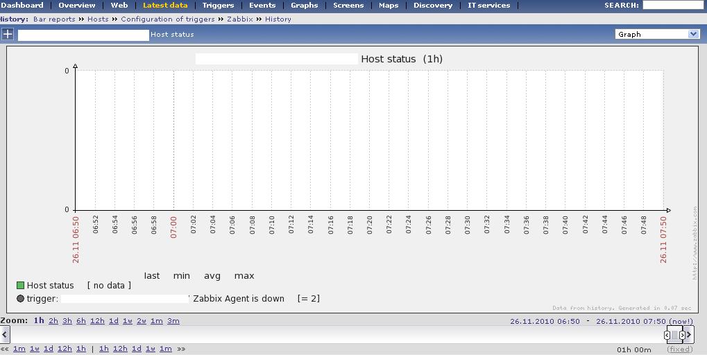

                        Hi All,
                        I was also facing some issues with the queues . But this is related to Graph queue , i am not getting the latest data Graph only for the Host Status , and for remaining all the services i am getting the graph as well as Latest data ,For Host Staus i am getting the error as " No Data" in the graph . It happend for me in the test server as well as Production server , so in the test server i disabled the zabbix Agent and enabled it after that i restarted the zabbix agent , its being worked , but in the production environment i cant stop the zabbix Agent , is there any way to fix this problem without restarting the agent . I found that some thing is wrong on the Queue , Kindly please help me out . Please find the attachment of the screen shot as reference and the template which i am using as well as My Zabbix Config file as well . Kindly Please help me out.
                        {Local Host:status.min(300)}=2
                        Note: In both (Production as well as Test) environment facing the problem only with the agent
                        Thanks,
                        Subbu
                        • subba5678
                          • May 2010
                          • 132
                          I updated the zabbix_server.conf with the changes posted in the forum , but still i am not able to find last data . Please help me out.
