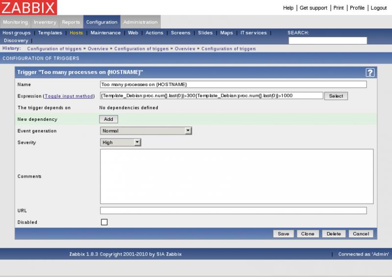

    how to fix corrupted trigger expression?
    Trying to adjust the max value for "Too many processes on {HOSTNAME}" the trigger got corrupted (see attachment).
    Replacing or deleting the expression and adding a new one did not work. Zabbix told me "Warning. Incorrect value for [expr_temp]".
    How can I fix this? Any helpful comment would be highly appreciated.
    Zabbix is version 1.8.3-2, as included in Debian.

      The expression box was read-only, when I tried. If I edit the trigger for the template, then I can fix it, as you suggested.
      Here is how to reproduce the bad expression:
      Edit the triggers of Template_Linux, search for "Too many processes on {HOSTNAME}" and click on it. Now you get an edit window for the trigger. Click on the [Select] box next to the expression, set "N" in the condition window to 1000, and click on [Insert]. Now you should see a broken condition as in my snapshot. There is no error message on saving the bad trigger.

              I am not quite sure about your terminology, but AFAICT I tried both. If I click on Configuration --> Templates --> Triggers(Template_Linux) --> Too many processes on {HOSTNAME}, then I can edit the expression box.
              If I use Configuration --> Hosts --> Triggers(myhost) --> Too many processes on {HOSTNAME}, then the expression box is read-only.
              For both I can click on Select, change the value for N, and click on Insert, giving me a broken trigger expression. I can save without error message in both cases, but for the "Hosts" case the new expression is ignored, including the new value for N.
