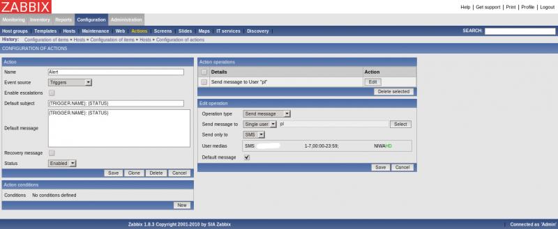

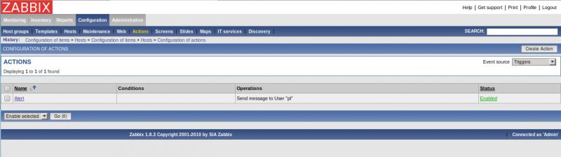

          Thanks a lot.
          I have attached a few screenshots, should cover it. Otherwise let me know.
          • untergeek
            Zabbix Certified Specialist
            • Jun 2009
            • 512
            From what I see here, you have an Action defined with no conditions.
            You need at least the following condition:
            Trigger value = "PROBLEM"
            In this way, the action is only executed when a trigger is live. This multiple-trigger effect is amply documented in these forums, as is the solution I have detailed.
