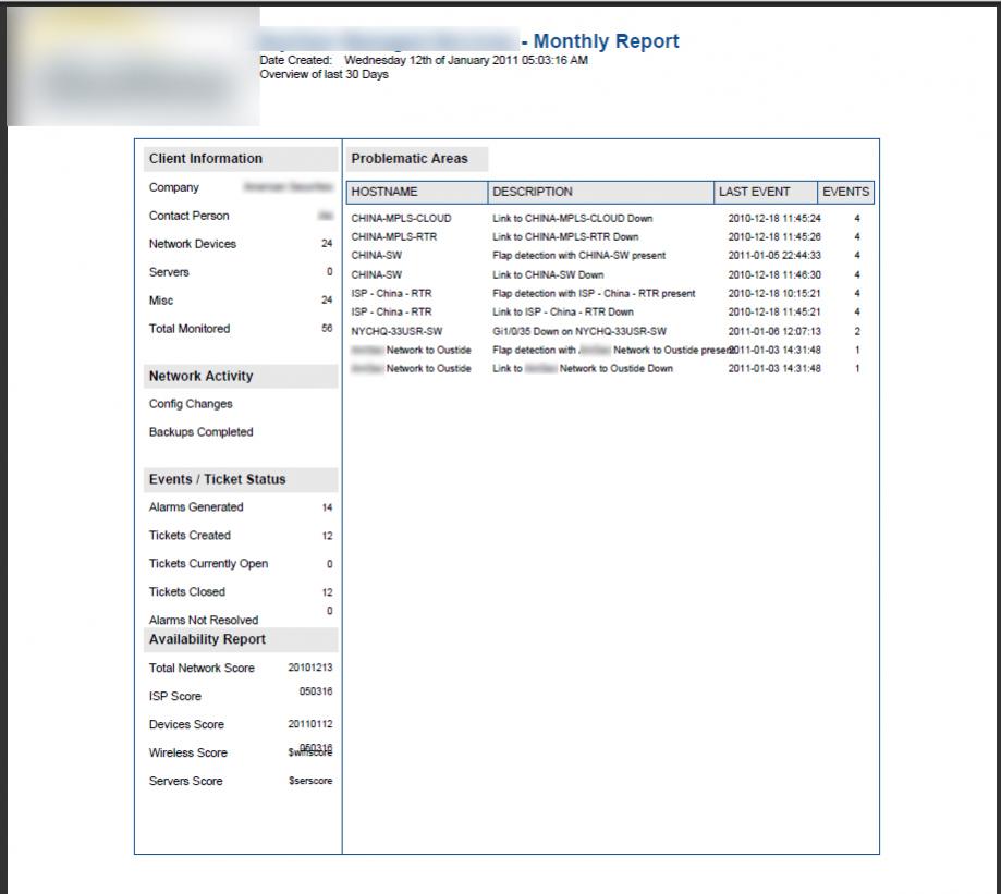

      Zabbix Monthly Reports
      i've been creating a Zabbix Monthly Report thats sent from the zabbix interface PHP to PDF and Emailed to the users address
      in the attachment is an image of the pdf emailed to myself
      also had graphs exported and applied to the pdf but decided to keep it simple
      the only thing i have left is getting the percentage of the availability for each category
      SELECT COUNT(*) as cnt, MIN(clock) as minn, MAX(clock) as maxx FROM events WHERE objectid=26435 AND object=0 AND clock>=1291755180 AND clock<=1294433634;
      i believe this gets the problem events that occurred between a 30day time period
      now i just need the total events to get the percentage i believe.
