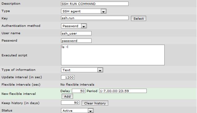

    I attached a screenshot of the UI, I hope the setup for the check is correct...

    2. You need to use "SSH agent" instead of "Zabbix agent" in your item setup (I don't know how you got a "Zabbix agent" type with "SSH agent" specific fields).

      to 2) What do you mean with SSH agent instead of Zabbix Agent? I followed the documentation http://www.zabbix.com/documentation/...ent#ssh_checks and added ssh.run as the key after choosing SSH agent (see screenshot above).
      Did I miss a point?

          Sorry, your setup in screenshot is correct. I don't know why I read "Zabbix agent" instead of "SSH agent" in type field (time to change my glasses)

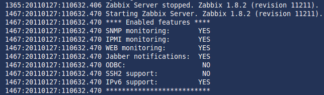

            The log file gives me the output attached below after restarting Apache server and zabbix-server.

              I tried to do it like that, but without success. I installed libssh2 and compiled zabbix with-ssh2 support.
              It may seem a stupid question but, did you install libssh2-1-dev or libssh2-1 only ?
              Development version is needed to compile Zabbix.
              It shows that ssh2 was not found.

              And what I get when Zabbix server is started:
               23095:20110127:114217.762 Starting Zabbix Server. Zabbix 1.9.1 (revision 16507).
               23095:20110127:114217.763 ****** Enabled features ******
               23095:20110127:114217.763 SNMP monitoring:           YES
               23095:20110127:114217.763 IPMI monitoring:           YES
               23095:20110127:114217.763 WEB monitoring:            YES
               23095:20110127:114217.763 Jabber notifications:       NO
               23095:20110127:114217.763 Ez Texting notifications:  YES
               23095:20110127:114217.763 ODBC:                       NO
               23095:20110127:114217.763 SSH2 support:              YES
               23095:20110127:114217.763 IPv6 support:              YES
               23095:20110127:114217.763 ******************************
