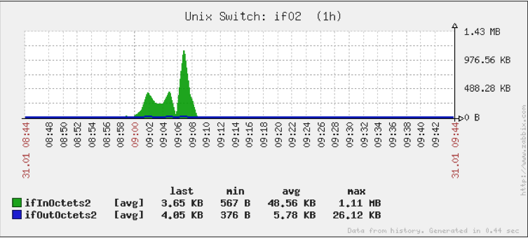

                      This is ultimately what I'd LIKE to do:
                      I want that if02 to be the actual name of the server attached to it. Not sure how to do this.
