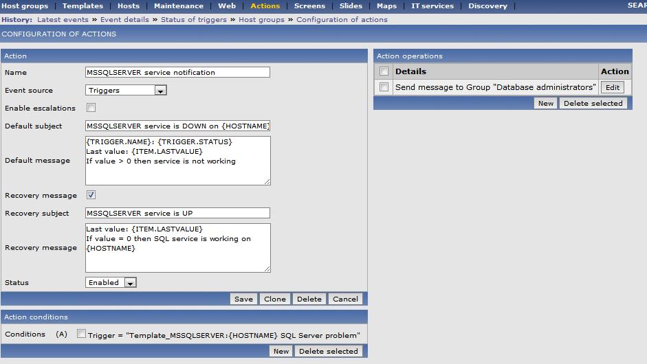

    Please have a look at the Action below.
    What I want it to do is send an email when the SQL Service goes down, i.e. when {ITEM.LASTVALUE} > 0
    I want it to use the first message, with the subject
    MSSQLSERVER service is DOWN on {HOSTNAME}
    If {ITEM.LASTVALUE} returns to 0, I want it to use the recovery message, i.e.
    MSSQLSERVER service is UP
    What is happening is that when {ITEM.LASTVALUE} returns to 0 the first message is sent again.
    So where am I going wrong? Any advice will be appreciated.

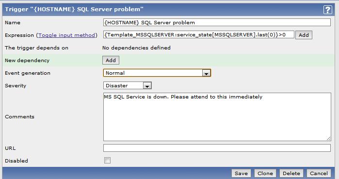

    The second graphic shows the Trigger setup.

    action condition needs to contain "Trigger value = PROBLEM"

      Many thanks. It works like a charm.
