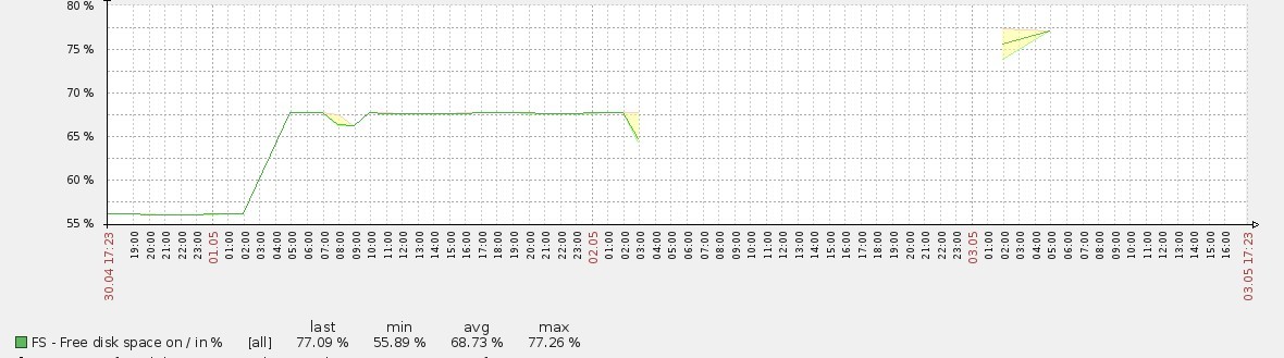

    My zabbix server cannot get data
    About 2 days ago, my zabbix server suddenly received few data, as you can see from the attachment.
    I checked the history data from mysql, it did show little data. All my zabbix server, agents, zabbix items are active and working.
    What's the problem?

    When I ping the agent machine, it returns "time=0.000 ms".
