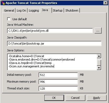

        Zapcat is there a JMX agent? JMXremote must run locally? with the command:
        -Dcom.sun.management.jmxremote
        Or should we specify a listener (the 10052?)? with the command:
        -Dcom.sun.management.jmxremote.port=10052
        -Dcom.sun.management.jmxremote.authenticate=false
        -Dcom.sun.management.jmxremote.ssl=false
        These orders must be placed in the Java tab of the Tomcat console? like this:
        Or so it must be specified somewhere else too?
        Sorry, i'm a newbie with Tomcat (and Zabbix)... But I really need help
