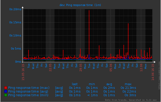

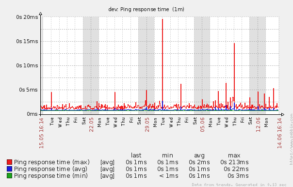

          Just to be sure, are you using a non default theme ?
          With default theme, week-ends are greyed (see graph-default.png) but not with «black and blue» theme (graph-black-blue.png).
