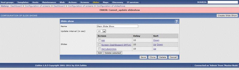

    I have several zabbix servers configured in different locations, monitoring local resources, they all report back to a central server using the zabbix distributed monitoring capabilities. Every thing works ok, except for screens and slideshows configuration.
    When I try to configure in the master server some screens everything works ok, I configure in each node a different screen for that contains what matters for each location, but when I try to add those screens to a slideshow it fails saying: “ERROR: Cannot_update slideshow”.
    This only seems to happen when I place in the same slideshow screens from different nodes, if all the screens are from the same node it allows everything to be created.
    Does anyone know why? All the help will be appreciated.
    I’m sending in an attach the screen shot of the error
    Thank you

    Same here
    Thank you
    Any progress on this, i'm having the same issue. Screens from different nodes in one slideshow = Error
