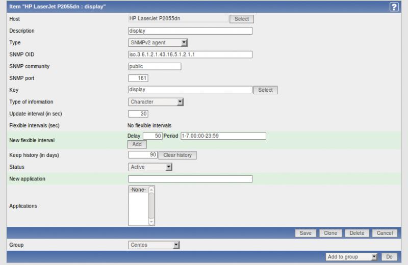

            It's SNMP
            See attachment

                  ok, why do you have "display" for your item name? "display" is your item description
                  • mvrasmussen
                    • Apr 2011
                    • 14
                    I cant get the data anywhere else than snmp
                    the item is called display because it resembles whats written in the display on the printer
                    • Davidus
                      • Dec 2010
                      • 281
                      No, I mean that you should have SNMP OID in your trigger expression instead of item description
                      {HP LaserJet P2055dn:display.strlen(0)}=10
                      In this case there is no link to your snmp item

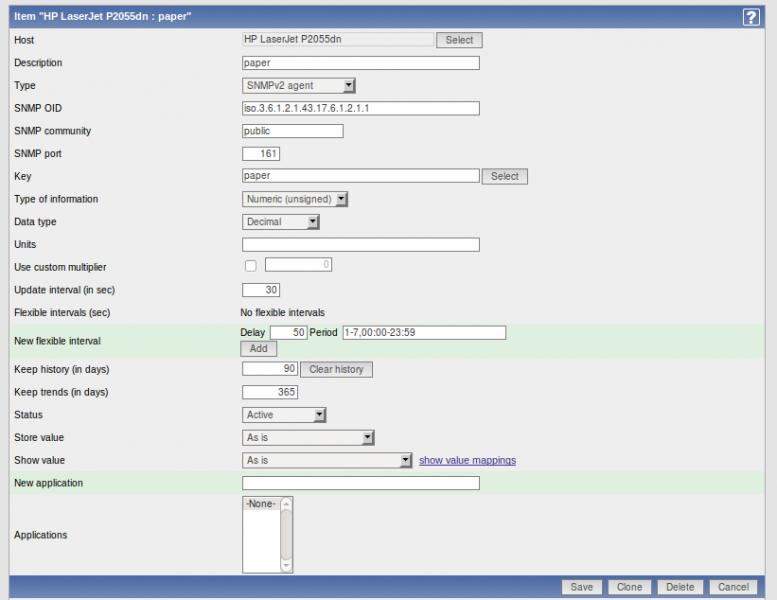

                          • mvrasmussen
                            • Apr 2011
                            • 14
                            The other item i have is attached
                            The trigger used:
                            {HP LaserJet P2055dn:paper.last(0)}=0
                            This is working fine
                            (The problem with it is that it goes to 0 with all errors, not just paper)
