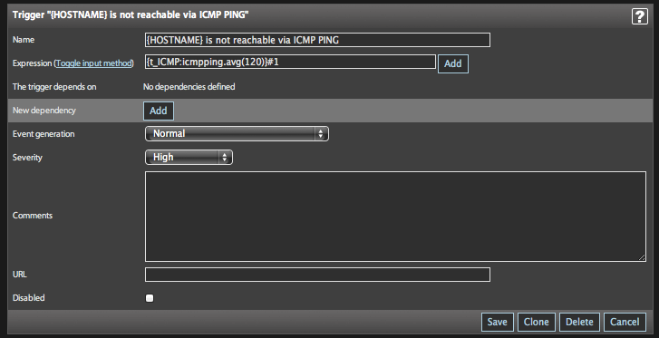

    I am having trouble tracking down what is causing this error when saving a trigger:
    Trigger "{HOSTNAME} is not reachable via ICMP PING" updated for host "abc.domain.com"
    Empty host name provided in expression.
    Check expression part starting from " {:icmpping.avg(300)}#1 "
    Trigger "{HOSTNAME} is not reachable via ICMP PING" updated for host "xyz.domain.com"
    Checked the hosts table and didn't see any obvious errors in hostnames. There are enough hosts that this trigger is assigned to that it's been tricky to find any host by process of elemination.
    I have debug logging on, but failed to find anything.
    Any pointers on where to look? I'm rather new to Zabbix so I am sure I overlooking something.

      no, pretty straight forward expression I think:
      {t_ICMP:icmpping.avg(300)}#1
      Fortunately/unfortunately I the issue got resolved without me figuring out why. In the hopes of trying to narrow down if the problem was happening to a particular host, I unlinked the template from all hosts, then one by one linked it again. As I linked it to a new host, I would try a save of the trigger to see if the error would occur. I ended up linking it back to all the original hosts without finding a problem. So I somehow cleaned it up.
      Now that I am not able to recreate the error, It likely going to be very difficult to figure it out.
