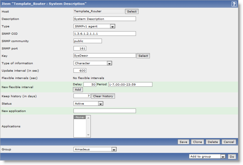

    I would like to query our HP Switch by using SNMP, but Zabbix does not give back any data.
    On the command prompt I can do a snmpwalk against the switch without any problems as well as I can read the device from with other tools.
    Anyone has an idea what I've done wrong with the item configuration ?
    (see attachment picture)

    Seems to me that your snmp oid is not correct.
    This would be the way to go for cisco switch
    I see that your trying to put last two digits to KEY field. This field is irrelevant.
    My advice, put the full snmp oid in place and copy that in KEY field as a sort of reminder. For me it's easier like that.
    Try that and let me know how was it.
      Drop the last "0".
        Thanks for your responses. Tried several things based on your comments but still no luck, while I just want to query the System Description
        Attached my current setting and the output of my snmpwalk

            Please put the full OID in place and show me results.
            I see in picture above that you omitted ending zero.
              I have created the item, and it works.
