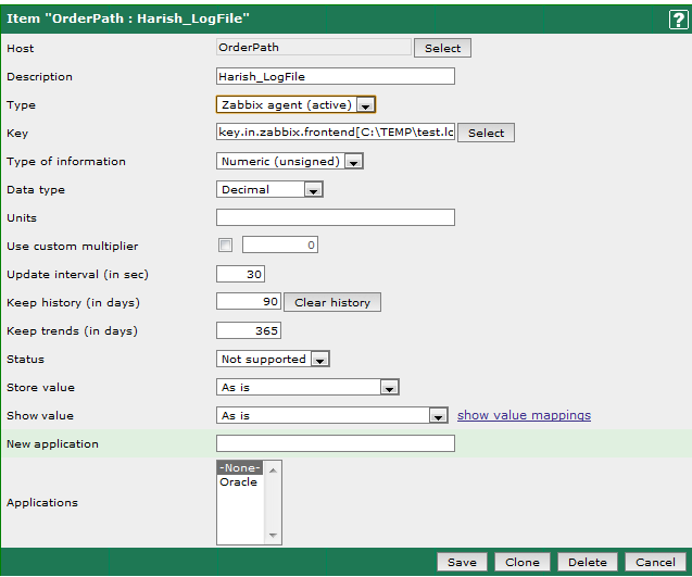

      #17
      Change in zabbix frontend -
      from Key: key.in.zabbix.frontend
      to Key: key.in.zabbix.frontend[c:/path/to/log/file]
      and set type:zabbix agent (active)

          #19
          its saying "Not supported" in status. Do we need to some changes in Item. I m pasting the screen shot please check

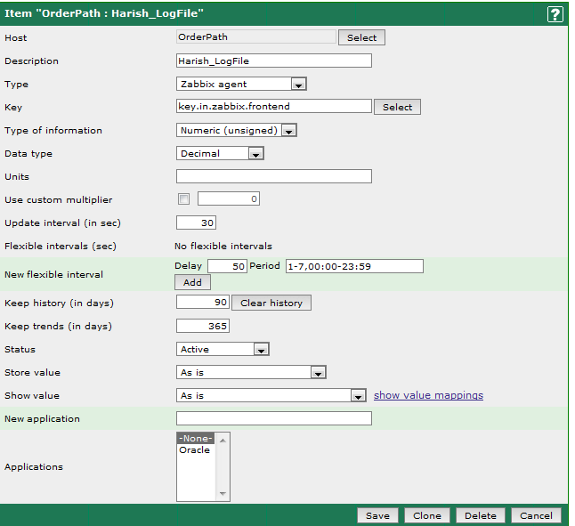

            #20
            Keep it simple - so only define the key without parameters.
            So in the key field should only be
            In the zabbix_agentd.conf you should define your userparameter
            without[*] and $1
            Parameters you can test in further steps.
            Change these things, enable your item and test it again...
            (the item should be supported!)
            don't worry

                            #28
                            Why do it so complicated?
                            Do an easy test:
                            UserParameter=test.zabbix.item,cmd /c echo 99
                            Your item should get the value 99, every time
                            and this is my item:
                            Type = zabbix agent
                            Key = key.in.zabbix.frontend
                            Type of information = numeric unsigned
                            data type = decimal
                            status = active
                            update interval = 30 seconds
                            After you create the item and update your zabbix_agentd.conf restart your agent and after 30 seconds you will see the first value...
                            test it...
