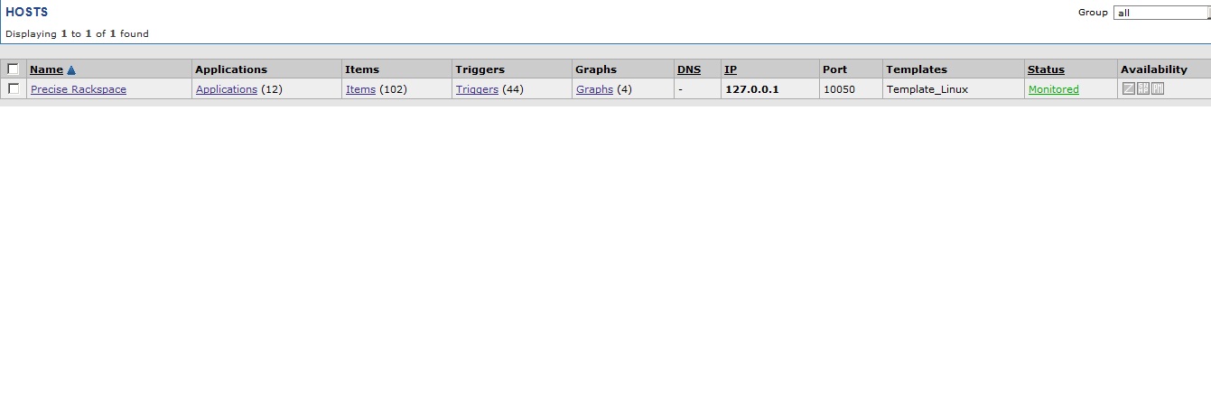

        Availablity Not Showing.
        In My zabbix Server Availablity not showing. Please check the Attachment.

              For the record:
              It seems to be important if the agent.ping item is a "Zabbix Agent (active)" check or a normal "Zabbix Agent" check. See this wiki entry:
              In a process of optimizing my templates, I changed all checks to "Zabbix Agent (active)" and that seems to be the reason why the Zabbix server didn't recognized availability status changes any more.
              hth
              tvtue
              • ninjait
                • Jul 2013
                As tvtue said
                you must apply a template on each host to be availability icon green.
