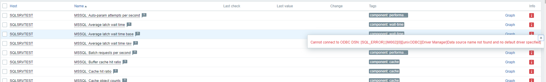

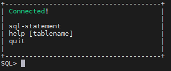

                          • nagaraj
                            • Dec 2019
                            Hello, I created a testuser in MSSQL and tested it using * isql sqltestsrv testuser testpwd * in the CLI. It appears to be connected and functioning, but the front end is displaying an error data source not found and no default driver specified error
                            Experts kindly advise.
