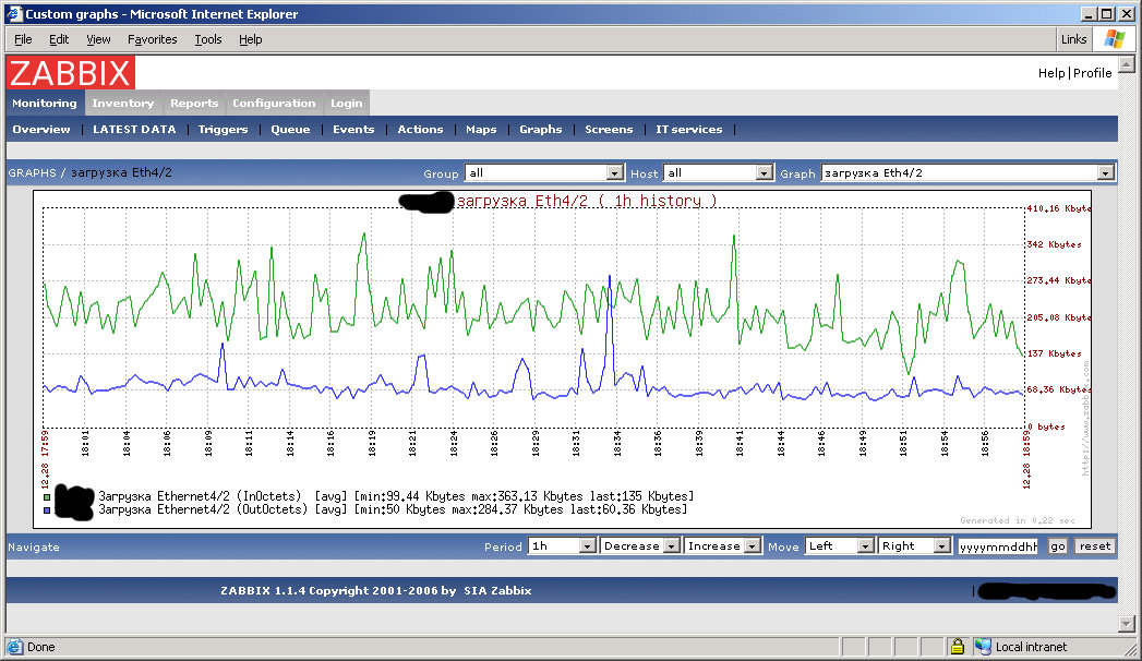

    Hello.
    Can I use cyrillic characters when drawing text in Zabbix graphs? Maybe I'm doing something wrong, because currently cyrillic strings are not displayed (displayed as unreadable characters). I suppose this is more PHP/GD issue than a Zabbix one, but maybe someone knows how to deal with this? Or maybe I should use different (i.e. UTF-8) encoding? (I use windows-1251 for now).

    After digging google I've found answer for the question above. It's defitively a GD issue. One should find appropriate fonts for particular encoding and recompile GD library, because Zabbix uses GD built-in fonts and they contain only latin characters (AFAIK). Will try to do so soon

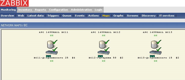

          Is anybody solve this problem with GD in latest zabbix versions? I use KOI8-R encoding, and labels for hosts is not correctly displaying on maps, is there any more elegance method, than recompiling GD? Thanks!
          • evgeny elkin
            • Jul 2007
            • 52
            Solved.
            Solve this problem by the easyest way for me - editing frontend code:
            In map.php
            # add a font for koi8-r
            $font="./fonts/cokoi8n.ttf";
            # and change a code
            # ImageFilledRectangle($im,
            # $x_label-2, $y_label,
            # $x_label+ImageFontWidth(2)*strlen($label_line), $y_label+ImageFontHeight(2),
            # $white);
            ImageFilledRectangle($im, 0, 0, 0, 0, $white);
            # ImageString($im, 2, $x_label, $y_label, $label_line,$label_color);
            ImageTTFText($im, 8, 0, $x_label, $y_label+,ImageFontHeight(2) $label_color, $font, $label_line);
            if($info_line!="")
            # $x_info-2, $y_info,
            # $x_info+ImageFontWidth(2)*strlen($info_line), $y_info+ImageFontHeight(2),
            # $white);
            # ImageString($im, 2, $x_info, $y_info, $info_line,$color);
            ImageTTFText($im, 8, 0, $x_info, $y_info+ImageFontHeight(2), $color, $font, $info_line);
