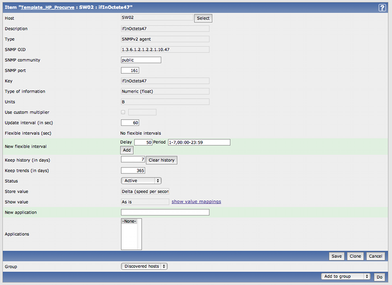

We have a bunch of HP Procurve switches, I've added them to the monitoring, linked the template and voila all ports ar graphed nicely. However, by default it calculates the results in MB/s. I'd rather have this as Mbit.
After some reading I found that you can set the Unit under the monitored item, but if I go there the Unit field is grayed out... (see attached screenshot)
I've done some reading, and the documentation states that I should change it in that location. Or as some have mentioned, you can hack the includes/func.inc.php file to blacklist MB or something like that.
Since I don't feel much for the blacklisting solution I'm wondering if someone can explain to me why the Unit option is grayed out and how I can eventually change this.
