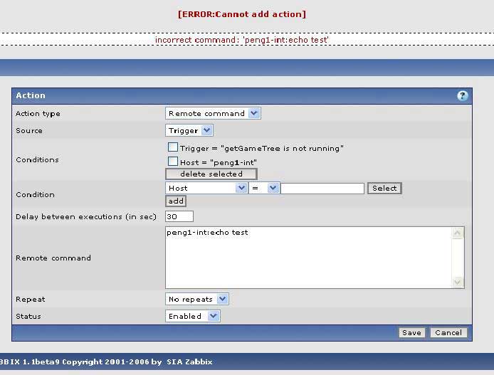

    Remote command walk through
    Does anyone have a step by step guide for setting up remote Command execution....I believe I have done it all correctly but I get the error in the screenshot.
    I have made sure EnableRemoteCommands=1 is on and I can see:
    system.run[echo test] [u|1]
    So what am I missing?

        That's what I have..see screen shot. And I have the Agent setup ok. but I get a "incorrect command" error.
        I have also checked permissions on the file and I can run it as user zabbix.

          I'm having the same issue. I'll have to get the sysadmin to check the sudo permissions, but other than that everything's set properly
          • rushowr
            • Jul 2005
            • 30
            Figured it out
            I'm moron sometimes.... I read the next thread in my search and found out that the problem was the fully qualified domain name being used as the servername. The host has to be a regular name, something about regular expressions not matching...
