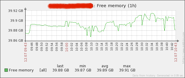

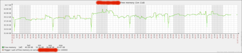

      I have one Solaris 10 box reporting in to a test Zabbix 2.0.1 server and am not seeing that issue.
      What item key are you using to get that metric? I am using the stock "Free Memory" item as shown below. And below that you can see a one month graph.

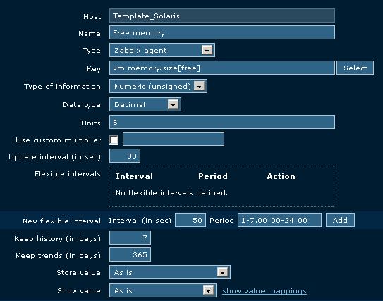

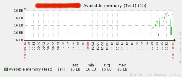

              Ok, so I took my "free memory" item and simply cloned it, replacing [free] with [available]. Leaving all other settings as-is.

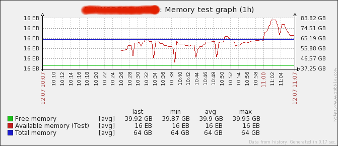

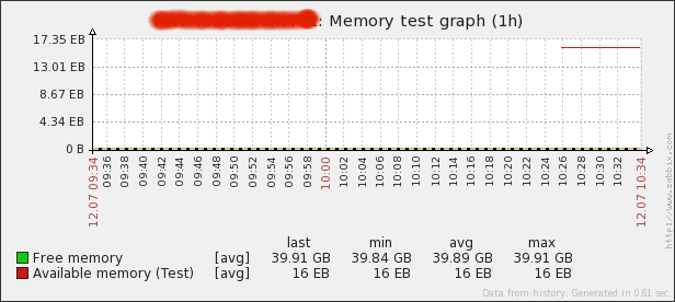

              I can confirm what you are seeing as per the graphs below.Out of curiosity, I added the "free" item and the "available" item into one graph to see how it would react. if I were you, I would abandon using the "available" key and switch over to using the "free" key for the time being.
              Then out of further curiosity (Final graph), I added in "Total memory", and moved the Y axis to the right side of the graph for the "Total" and "Free" metrics, and left the "Available" metric on the left side. Interesting results. The "Available" metric to totally skewed.
