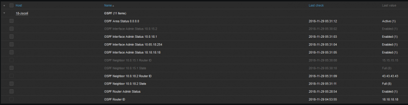

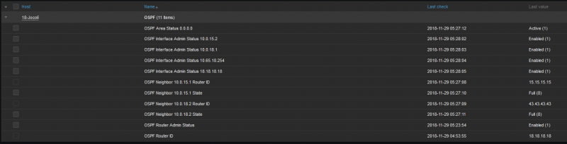

            Hi can you resolve it? Because i've a similar problem with OSPF protocol over HP Switch.
            I will like to monitor when the adjacent routes are down but i can't get results... i'm using the Stephen Fritz template version 2.0 available on the next link
            These is when OSPF Neighbor State its ok.
            These is when OSPF Neighbor State its down.

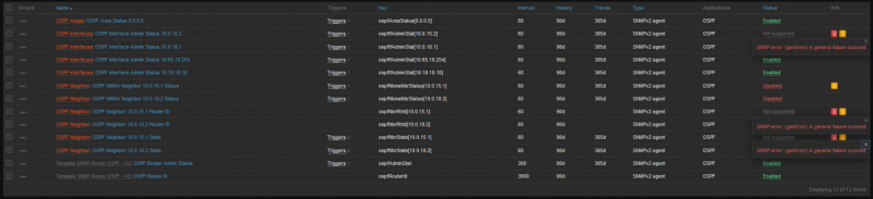

            And these are the mistakes that I get (Items)
            The red letters says:
            SNMP error: (genError) A general failure occured
            And these are the mistakes that I get (Triggers)
            The red letters says: Cannot evaluate expression: "Cannot evaluate function "Jocoli: ospfNbrState[10.0.15.1].last()": item is not supported.".
            Cannot evaluate expression: "Cannot evaluate function "Jocoli: ospfIfAdminStat[10.0.15.2].last()": item is not supported.".
